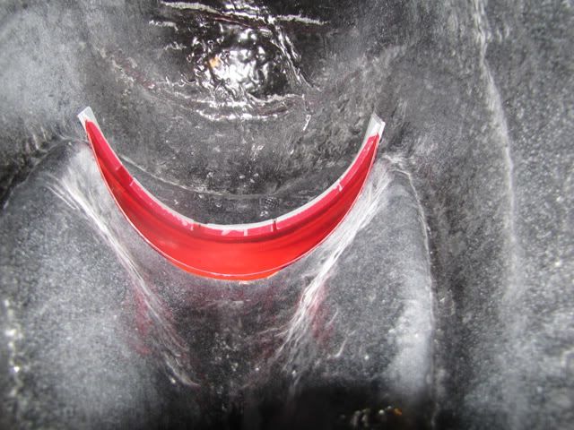

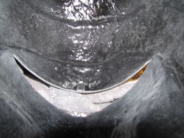

As for how to attach your visor. I went an interesting, and somewhat tricky way. I attached a rare-earth magnet at the top of my visor
And then I took a piece of metal, bent it to shape and glued the visor to it and now the visor pops into place.
I get a good 1/4" gap at the bottom of the visor so I get airflow but you can't tell there is an opening. One of the last troops I was at I had a 4-year old boy decide to poke my eyes out and kept hitting my visor. It popped out, hit my head and then snapped back into place...over and over and over again before I could stand up again. The good news is that the visor wasn't damaged and all I had to do was step inside a room and reposition it again.

Thanks for great advice - I think that is the best way. I was thinking about how to glue the visor, how to keep it in place till the glue starts working - it is quite hard to bend. But glueing it to the metal sounds great - the metal is glued only on the top of the visor, right?JesterTDA wrote:Well for me I wouldn't even consider the helmet liner as that woudl be just one more piece of cloth covering my head...but that is a personal choice. I made the mistake of spraypainting the inside of my bucket with a nice black Krylon Fusion. I figured it would help keep things darker inside AND protect my face from the fiberglass. Turns out, my cheeks rub up against the paint and because it's so hot and humid I end up with black cheeks after every troop. It's rubbing off though so it's getting better.

Yeah, the metal I used for my visor cost me about $2 at a home improvement store. It wasn't too heavy but it also wasn't super easy to bend. Just make sure a magnet can attach to the metal, the first type I choose wasn't magnetic. I just glued and clamped the visor to the metal for a night or two (I used CA glue) and that isn't going anywhere. Just make sure you bend the visor metal before attaching the visor. I used some extreme temperature glue which holds up to high and low temps and high humidity (it was designed to be used in washer/dryers and freezers) because the inside of your helmet will get hot and humid, trust me.
