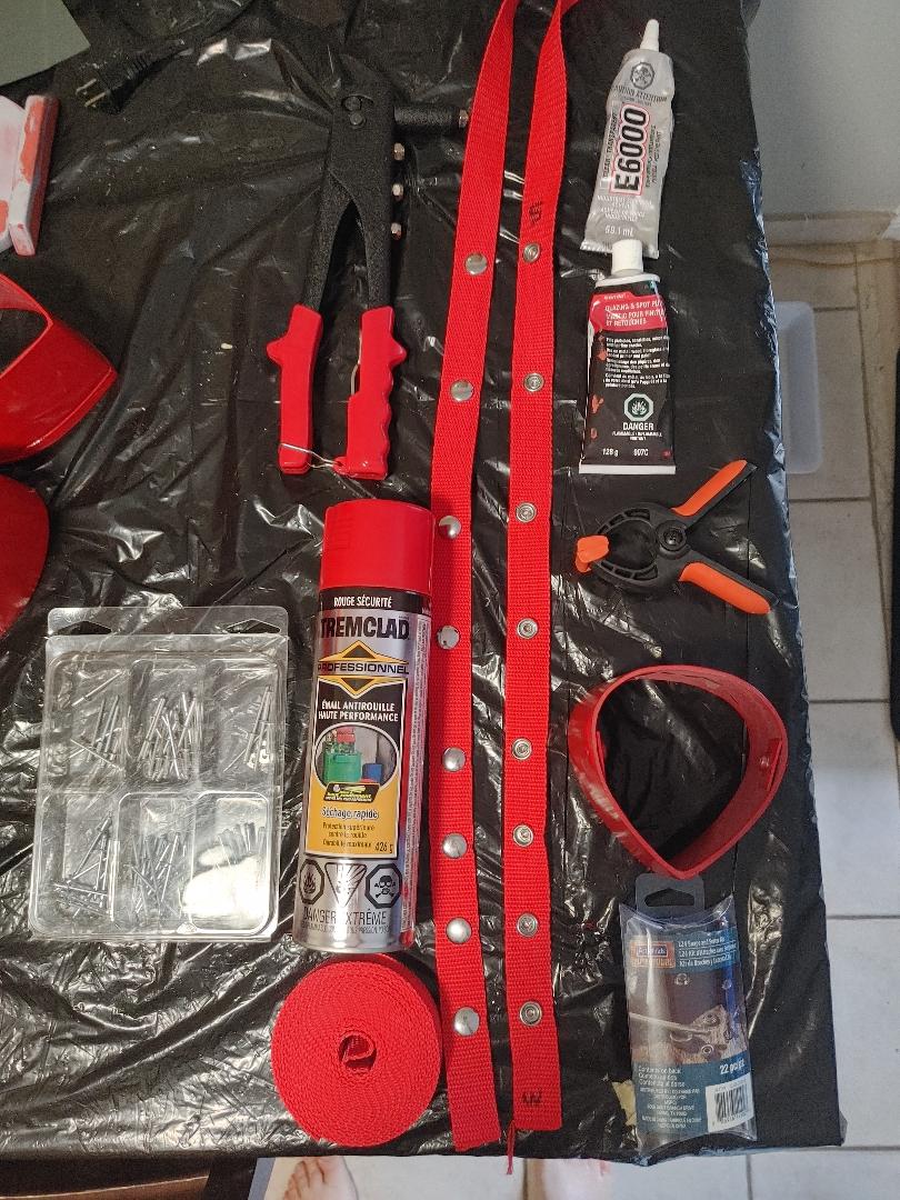

Items used so far.
1000 grit wet/dry sandpaper. Used at the beginning and in between each step.
Primer filler spray
Spot putty
Safety red spray paint
1" red strapping
Plastic cut into 1'" squares
Snaps
Rivets and rivet gun
E6000
Clamps

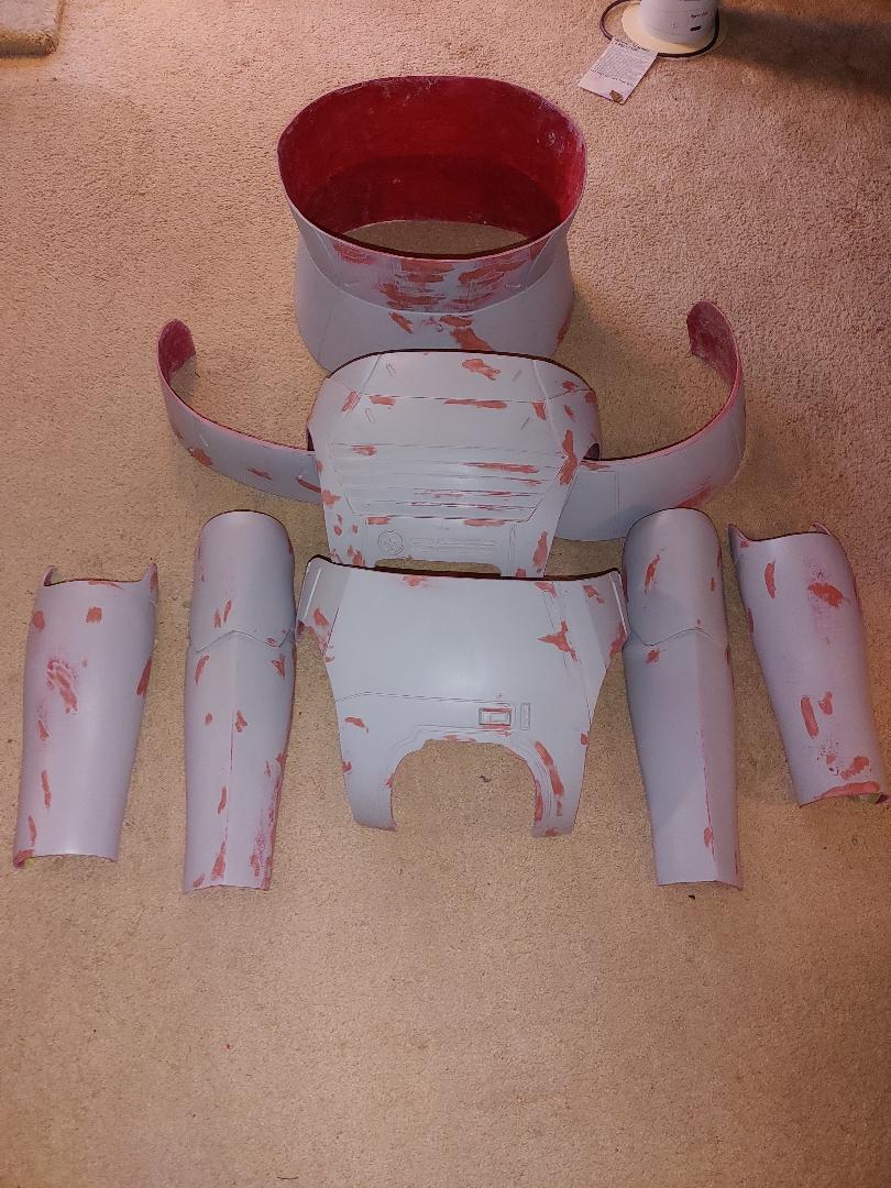

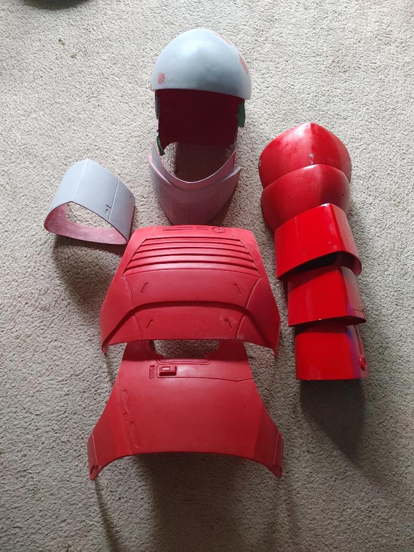

I have attached a couple of pictures that show the various stages of progress and the items I have used that are listed above. You will see in the first picture the before (chest and back piece), middle (helmet and face plate) and finished (arm armour) progression. The second picture shows the items I used to work on my kit minus the primer filler as I threw out the can. i decided to rivet the snaps onto the squares of plastic to have a stronger hold as I may need to remove individual segments for either storage or repairs.
First step was to wet sand all the parts to rid them of any rough spots from the molding process. I then worked on the snaps which involved riveting the male part onto a square of plastic and attaching it to the piece using E6000 and a clamp and allowed it to cure for 24=36 hours. I then measured out a strip of red strapping making sure to allow for 3" of reveal for the top 4 sections and 2" of reveal for the bottom 4 sections. I marked those measurements on the strapping and used a soldering iron to burn holes in the strapping to keep the strapping from tearing or fraying from wear. I then secured the female part of the snap to the strapping using the supplied directions in the snap kit. The next step was to coat each piece in primer filler and allow it to dry. This will show any dings, dents, or defects in the piece. After the pieces are dry, another sanding was done in order to eliminate any roughness in the primer filler. I then used the spot putty to fill in the dent's, ding's and defects and allow it to dry. After the putty has dried, another sanding was done to smooth out the piece I was working on. After I was satisfied that I had it smooth enough, a coating of safety red spray paint was applied. Once the paint had dried, I examined the piece for any defects such as overspray or runs in the paint. If any were found I had to sand those areas again until I was satisfied that the issue was resolved and another coating of safety red was applied. .

The last of the armour has been sanded, primer filled and sanded yet again. My advice to anyone thinking of doing this character, start with the big pieces first. Sure there are a lot of smaller pieces but they are not as awkward to work with as the larger ones. Larger pieces don't equal easier and smaller pieces, despite being more, doesn't equal more work.
