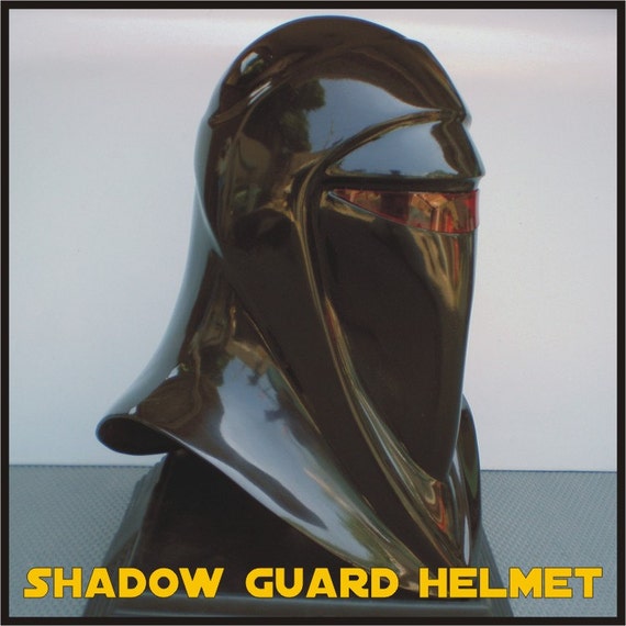

So I am wanting to build a shadow guard as my first outfit for joining the 501st. I have been pouring over the CRL's trying to make sure all the things that I have picked out are up to spec. However, as this being my first build, I would welcome the outside opinions of the other Sovereign Protectors to make sure I am doing this right.
Helmet: https://img0.etsystatic.com/019/0/88558 ... 2_ae63.jpg
Seamless fiberglass wearable helmet rendition, larger than the Don Post helmets and accurately proportioned, has FULLY padded and lined interior. This is not a cheap vacuum-form or delicate slush/roto-cast resin, it's fiberglass reinforced UV-cobalt cured polystyrene formulated resin, more like a hefty quality motorcycle helmet. The lens is 1-1/2 16"s (3/32) thick hard red thermo-formed acrylic.

for me the armor kit is not good (shins and shoulders are totally wrong) :|
Re: Question about Shadow Guard Outfit
The helmet and armour are star fortress pieces and will not be approvable for multiple reasons. There are many other reasons to not use this product if you do a quick google search for StarFortress.
The jumpsuit will not be approvable with buttons on it as shown. The jumpsuit cannot have any visible zippers or buttons on it. You can find better options by searching for black flight suits and not jumpsuits.
The belt will require modification to be approvable. The grooves are missing and will need to be added. If the belt is not leather, this will not be achievable.
The Gloves have stitching on the back of the hand which renders them not approvable. The gloves must be smooth with no extraneous stitching as is shown with the gloves you have looked at.
There are many resources here on the forums for sources of these pieces. Have a look around and always ask questions before buying anything!
