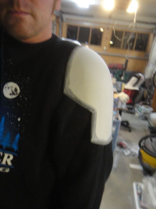

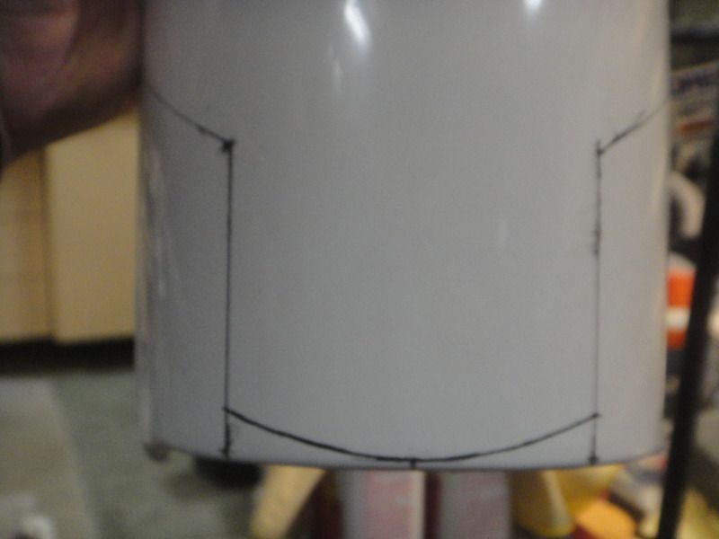

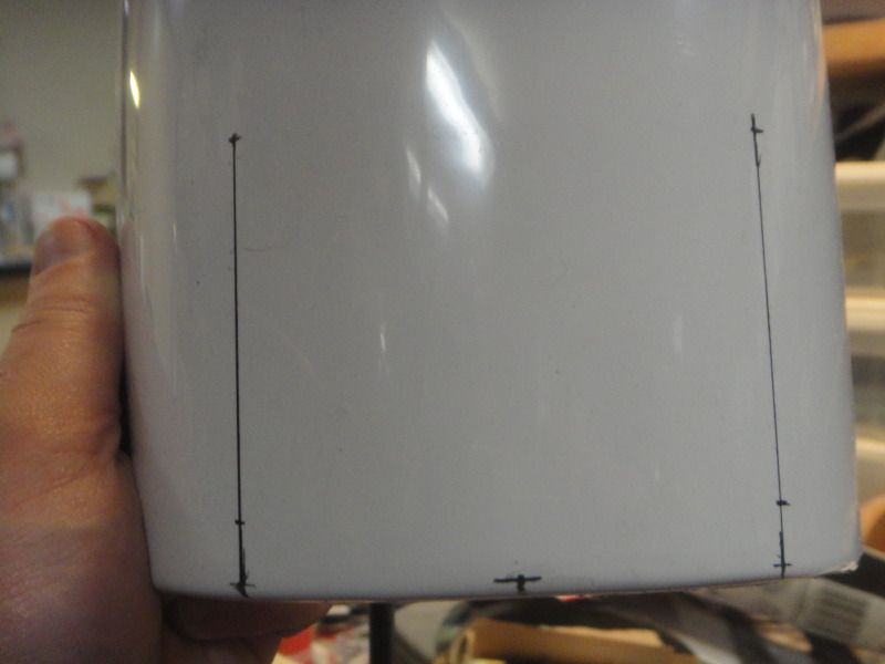

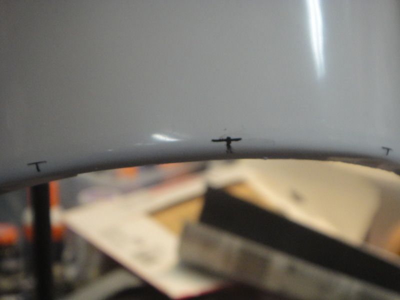

I'll show the process on one of my final-draft bells. I start by finding the center of the bottom edge, and making reference marks for a 97mm width (so it's pretty much an even 10cm once the trim is on):
Then I use an edge square to put the verticals in -- 1cm up is a mark for where the bottom curve will end, then 65mm for the actual edges:
35mm further up on the outer edge is where the angled edges end:
And then the bottom arc:

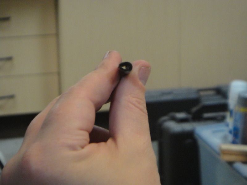

A cross-section of the car door trim I use to put the raised lip around the edge:
And my "learning draft" in place. I botched the placement of the trim, and the Bondo Plastic Metal reacted with the ABS. It eventually all fully cured after a few weeks, but I decided to just have another go and be more careful each step of the way. Also, I apologize for the lack of reference points with a black sweatshirt. I'll try to get another shot in a T-shirt, so you can see how it comes down to a couple inches above my elbow:

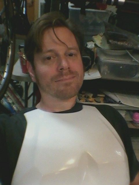

While I'm at it, here I am pleased to find my chest armor fits quite nicely (next is to extend the shoulder and side projections):
--Jonah
