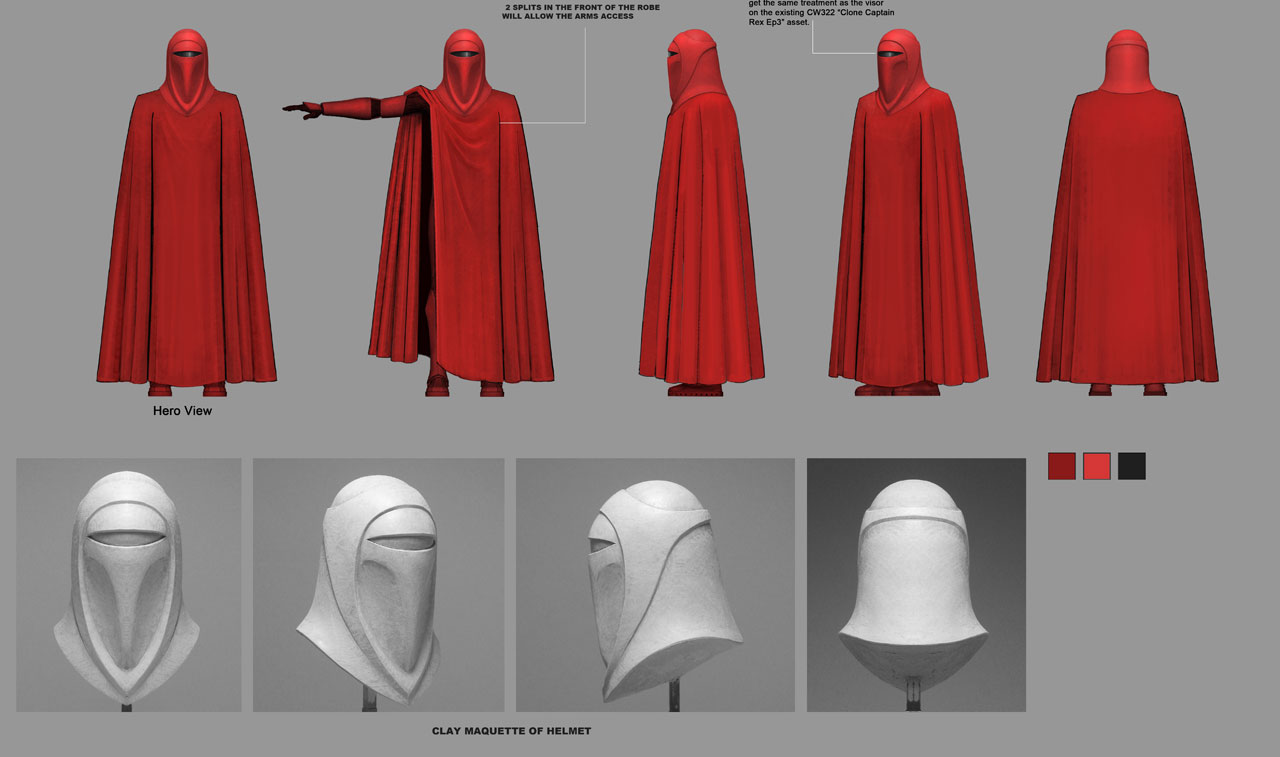

LuciousTalvloinne's post brought up a question for me though. This will be a ROTS build and he noted the ROTS helmet as being similar to the TFU and clone wars helmets which appears to be what the Pep file I used is modeled after. So is this helmet style valid for an ROTS build or is the ROTJ and AOTC style standard across the board for 501st approval?

I think I may have found my answer
Because it is Episode III I am aiming for it will need to taper out but to a lesser extent than if it was a II or VI build
Picture reference
Adding about a half inch to each side lowering the slope down should bring it very close to this reference pic
